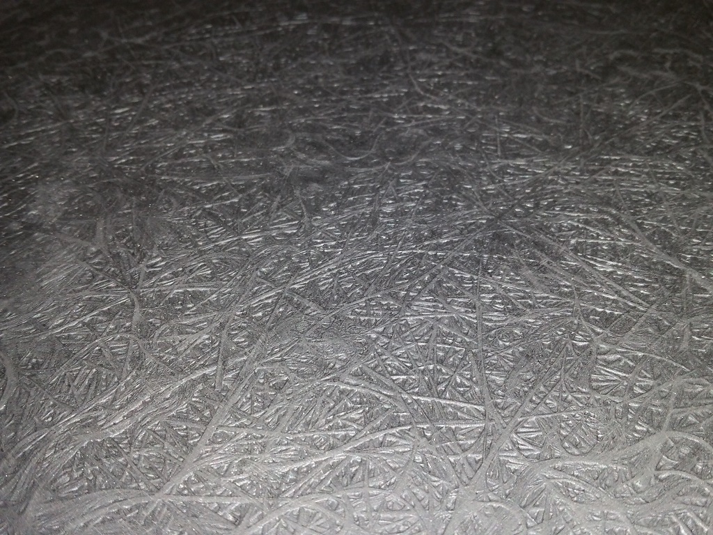

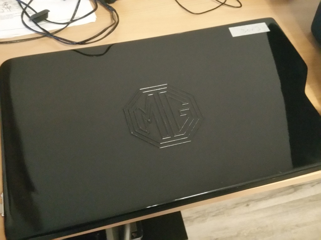

I just want to share some impressions of the box:
20170627_212015.jpg [ 155.03 KiB | 100296-mal betrachtet ]
20170627_212158.jpg [ 379.58 KiB | 100296-mal betrachtet ]
20170627_211931.jpg [ 184.63 KiB | 100296-mal betrachtet ]
20170627_211940.jpg [ 230.33 KiB | 100296-mal betrachtet ]
It seems so the part is made out of the Material "PUR" with a tool from April - August 1996.
