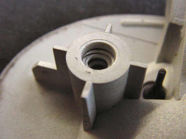

1. the two bolts may kill the thread in the plastic part when you bolt off the grip
http://www.mgfcar.de/door_grip/thread_dsc08949.jpg
(be prepared with two short M6 srews as replacement for the original)

M6 x ?
Gruß, Herbie
Mo 12. Jan 2009, 22:54
Beitrag Re: Fitting chrome door handles
M6x10
or M6xany + Bild
