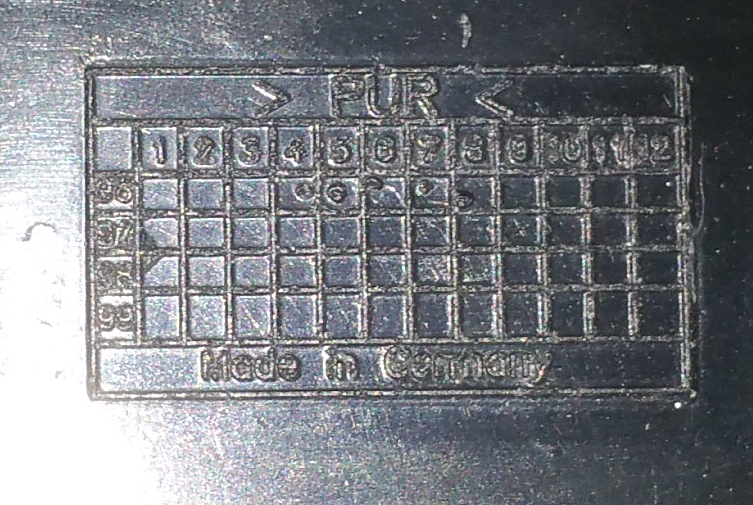

It seems so the part is made out of the Material "PUR" with a tool from April - August 1996. Dateianhang:
Label.png [ 872.96 KiB | 74727-mal betrachtet ]
One last question. Can someone show a picture how much to cut out of the front trim to fit this box? I have an ordenary 185er Spare Tire.

Tomcatciller hat geschrieben: Today I with a tool from April - August 1996.
no, production date August 1996, adding on dot more, September, and another dot, October, .....

Well, I think my sentence and questions are still correct. My box was produced with a tool from August 1996,you are right. But I wrote " with a tool from April - August 1996". So the tool was used for 5 months and is 21 years old. This was my message. I care more about the question of tooling then the part, because I wonder how Cowacarparts Supplier can reproduce this boxes. First I thought this is a some kind of reconstruction, now we know someone has the old tools and reproduce these boxes to OEM Spec. Similarity is quite safe. According to my question for a picture of the cut front trim: Of cause I read Dieters Webpage and found the installation picture there: http://mgfcar.de/stau_box/frontbox.htmlBut in this thread I also read the sentence in Post N0 5: Dieter hat geschrieben: You need to remove much more material from the bonnet cover than shown on paper.
