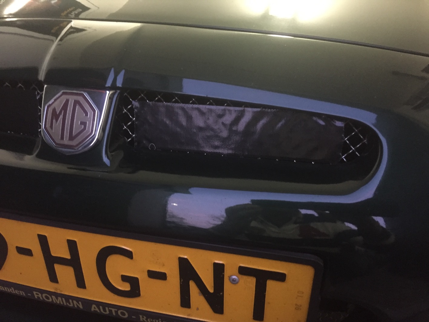

Two days ago I decided to 'duct-tape' all air intakes at the front of the car more or less shut and 'surprise-surprise' coolant temperature reaches the normal level (one notch below the middle) in about 5 minutes en oil reaches a 100 degrees in about 10 minutes. Both 'rock steady'...
One of the main reasons for head gasket failure is thermoshock because of the amount of cold water from the radiator and the position of the thermostat. IMHO this steady temperature AFTER duct-taping the inlet decreases the thermoshock risk, doesn't it?
Is there something wrong with my reasoning? Is there anybody on this forum with experience with taping off the mesh inlets? (I can't think of anything against this procedure because oil and coolant temperatures are normal now and steady....)
