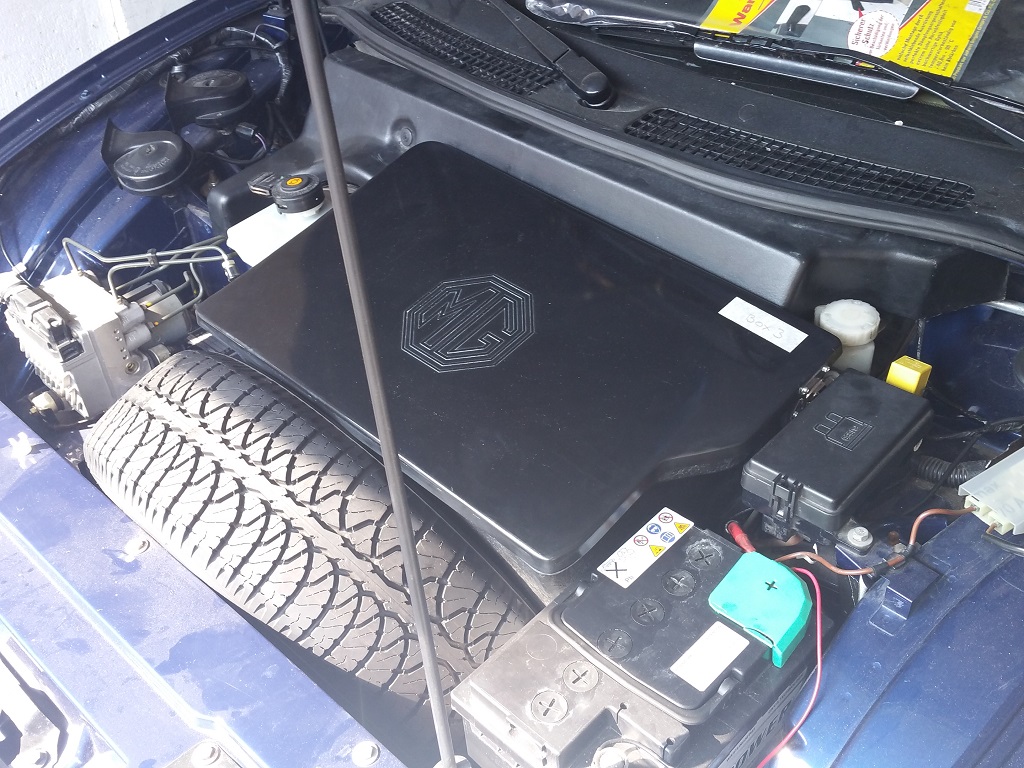

I fitted the box today.
First cut of the front trim I tried according to the OEM installation manual:
20170708_162811.jpg [ 271.94 KiB | 103215-mal betrachtet ]
And for the first try very good, it fits.
20170708_163833.jpg [ 315.5 KiB | 103215-mal betrachtet ]
But its seems to be not very even. Battery side sits a bit lower. Due to that fact of poor build quality or heavy loading there is a gap:
20170708_163842.jpg [ 305.58 KiB | 103215-mal betrachtet ]
Sa 8. Jul 2017, 18:52
Beitrag Re: Frontbox and a/c
Check the lower seam where the box should rest in the spare wheel space.
The seam of the box should go behind the metal part... direction cabin.
Is it ?
